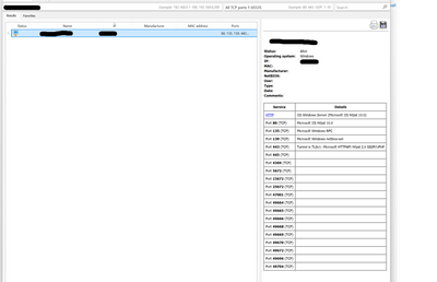

We also did a port scan, and it seems that port 10000 isn't open on the App Server, even though we have disabled firewall.
Should I try another port?
Thank you for your help in advance
