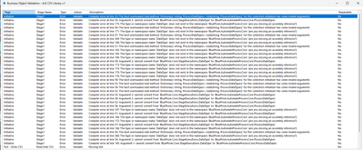

Upgrade from 6.5 to 7.3 BluePrism.AutomateProcessCore.dll not having the DataType function
Alot of our custom object now have compile errors in version 7.3 due to the below error. Does anyone know what the new "function" for DataType is within the AutomateProcessCore.dll for 7.3? I cant see any comparable type that i can update the code to use. Any help would be greatly appreciated.
Page: Initialise
Stage: Stage1
Type: Error
Action: Validate
Description: Compiler error at line 80: The type or namespace name 'DataType' does not exist in the namespace 'BluePrism.AutomateProcessCore' (are you missing an assembly reference?)
Repairable: No
