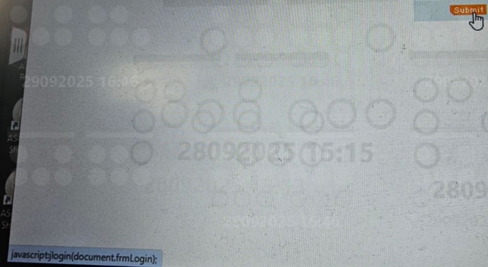

I tried the above approach to click submit button with regards to the JavaScript shown on the bottom left. However, navigate stage not able to click.
May I check if you have clicked based on the value shown when u hover over the button to be clicked?
Thanks alot in advance.

While there are other workarounds listed in that support article, the only method I've tried is using UIA/AA to click it instead. Personally I'd just try to stick with that if it works. Plus UIA gets faster as of v7.4.1 anyway so it should run faster for you at that point. For now, AA is faster because of the ability to use Match Index and Match Reverse to increase the speed.

Somehow, UIA mode is not reliable for us in one of the process where application is a legacy one. Every time new session is launched, attributes changes. Hence, thinking to use JavaScript as shown above in the earlier chat.
Appreciate if you can provide some pointers how to use that to click.

Try AA instead of UIA. If it's a browser mode object, then AA won't be available by default. But you can temporarily change the application type to Windows application, spy in AA, and then switch the application type back to Browser. Your AA elements will still work and you can still click highlight on them. Be sure to use Match Index and also try Match Reverse (try both True and False for Match Reverse and see which one is faster and use that).
