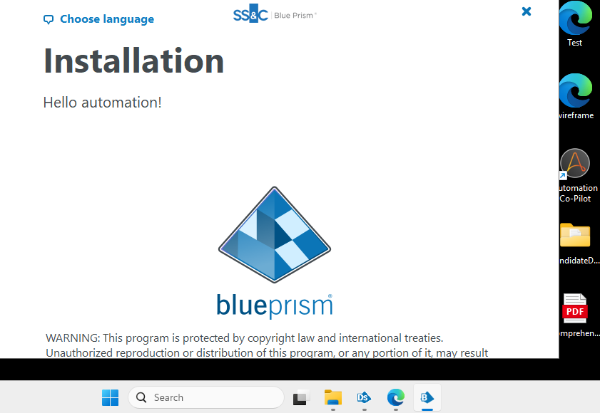

There appears to only be a screenshot of the installer window with no errors or exception information, with no details about the problem scenario in this post -- can you first please describe the problem you're experiencing here so others could help?
Their is  No forward option is available.

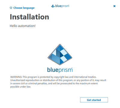

I believe your screen resolution may be too low, which is causing the “Get Started” button in the bottom-right corner to be hidden.
Could you try increasing the screen resolution or screen size to see if this resolves the issue?
Here is the example of the screen.

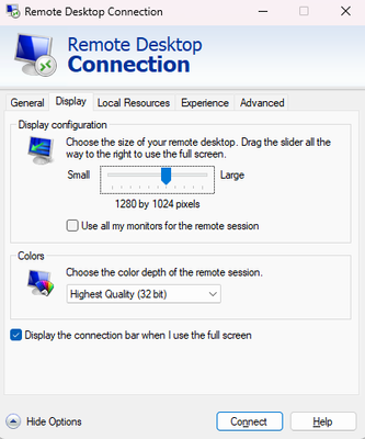

Wittawat
You may try moving the installation dialog by clicking and holding the mouse near the left side of the dialog. Then move the dialog.
For your information.
If you RDP to the PC, you may not have option to change the screen resolution. You have to update the resolution before you make the connection.
