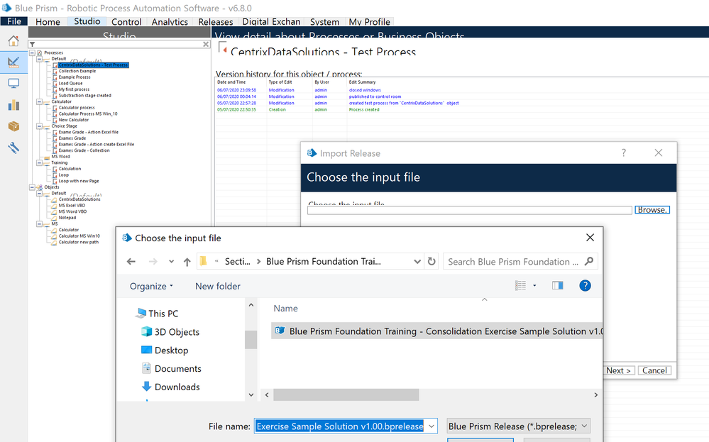

Someone to explain the problem with the filename release?
"Blue Prism Foundation Training - Consolidation Exercise Sample Solution v1.00.bprelease"

andrew.beard
Hi Graziela,
I can't see anything wrong with your filename. Can you pls provide further information such as the error message you were encountering?
Note, I was able to create a release with this name and import it with no issue.

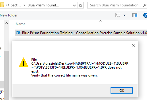

The error ist..
I did not specify but it is the path/filename... sth with the paht that is not explaining in the course how to do or it was with an old version.

Thanks for the extra info Graziela.
From what I can gather it may be a Windows issue - users of other software have encountered this problem "because Windows has a maximum length of 260 characters for folders created on your computer's hard drive." I suggest saving the file to C:\Temp and trying to load the release from there.
See example info - here
As per your request I'll email you directly as well.
Hope this helps.
