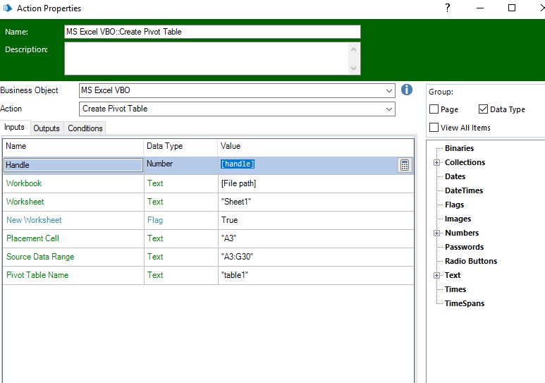

Hi All,
I  was trying to create a pivot table using excel vbo but i was getting error can anybody help with what is the input for it
Note : Attached pivot table input and error i got

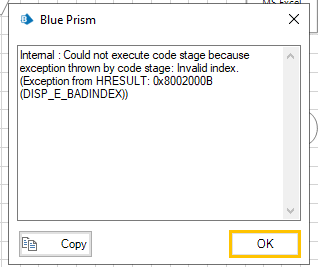

Hi Sudha Priya,
Pivot table is expecting  the column names as list
Check below threads
https://www.contextures.com/excelpivottableerrors.html#:~:text=The%20pivot%20table%20error%2C%20%22field,the%20source%20data%20is%20blank.
https://www.wallstreetmojo.com/pivot-table-field-name-is-not-valid/

Hi Sudha,
The input field labeled "Workbook" expects a workbook name as its value. I can see that the current value mapped to this field is the file path of the workbook. Please update the value of the "Workbook" parameter to create the pivot table.

Hi Athiban,
I have changed the workbook name but im getting new error
