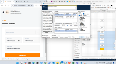

Unable to write date to the website box and also to click and input details gotten from a dropdown.
blazino17
blazino17_0-1730389818455.pngI'm encountering issues with entering a date in the website's input field and selecting a specific option from a dropdown list, which should also allow text entry and pressing enter. The actions don’t appear on the site, and no errors are shown. I’ve also tried using Global Send Keys within a navigation stage but it is still not successful. Could you please help?

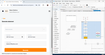

I used Browser Mode to spy the elements and employed both Global Mouse Click and Global Send Key to interact with the website. However, while no error appeared, the automation moved to the next stage without any action taking place on the website as expected. Interestingly, the email section worked smoothly, but I’m currently uncertain how to resolve this issue. Please review the attached for context.Thank youu
The UI Mode is not capturing the application so that's why i am using browser mode
