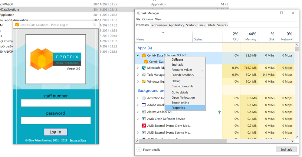

Usually this error is caused because of incorrect parameters only. You might check if you are including the '.exe' extension with the process name. If you are using the extension, the process name won't be recognized. In order to get the correct process name, once you have launched the application you can go to the Task Manager and from there you will be able to view the process name. In the below example, I am showing the steps with Training Order Application.
Step I: Launch the application and then open Task manager. From there you right click on top of the application and then select the 'Properties' option:

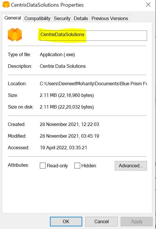

Step II: You can see that the highlighted text is what should be actually given as the process name here:
Also, attach action many times does not take 'Windows Title' properly. You can try to just provide the 'Process Name' parameter as I have shown above and check if you are getting the correct result or not.
