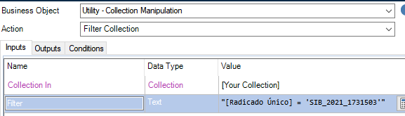

John__Carter
Hi Lina - I'm replying in English as I don't know Spanish. The basic way is to loop through the collection and use a decision stage to look for the value. Another way is to use the Filter Collection action to find the rows matching your filter condition. If the output collection contains no rows, then the value does not exist in the input collection.

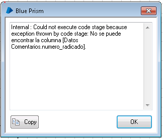

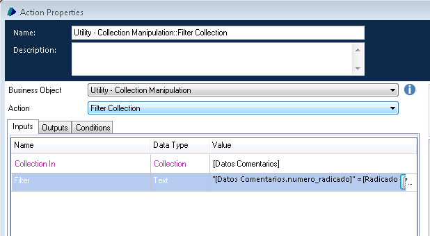

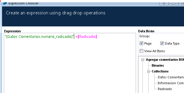

LinaRocio
Buen Dia,
Me esta Generando este error, no se porque pueda ser:
lo estoy realizando de esta forma: [Datos Comentarios.numero_radicado] es la colección donde esta el radicado que quiero buscar, el cual se encuentra dentro de la colección [Radicado]

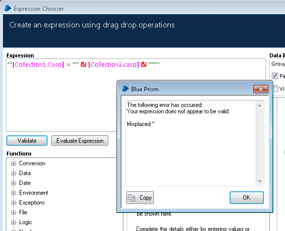

LinaRocio
John,
What I want is to search for a field of a collection within another collection, that is, I have collection 1 in which the "Case" field is with the information I need and collection2 is where the "unique case" with which I go is to look for in collection 1.
I don't know what data I'm missing or I'm placing it wrong
PabloSarabia
Level 11
Hola @LinaRocio
Prueba usando esta formula:
"[Caso] = '" &​ [Collection2.Caso] & "'"
Espero que te ayude!
Nos vemos en la comunidad, saludos :)
