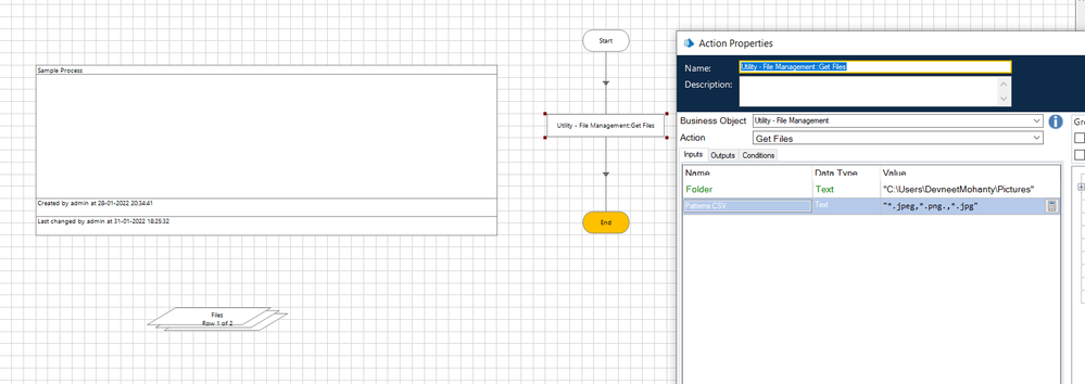

Hola, soy nueva en Blue prism y quisiera saber que objeto me sirve para obtener el nombre de unas imágenes ubicadas en una carpeta especifica.

can use the 'Get Files' action of the VBO 'Utility - File Management' using an action stage. Here, you need to provide the 'Folder Path' where your images reside along with the pattern of the files that may occur.
Suppose that, in your case, you know that the images can be in PNG, JPG or JEPG format, then you can provide the value of the file pattern as '*.jpg,*.jpeg,*.png'.

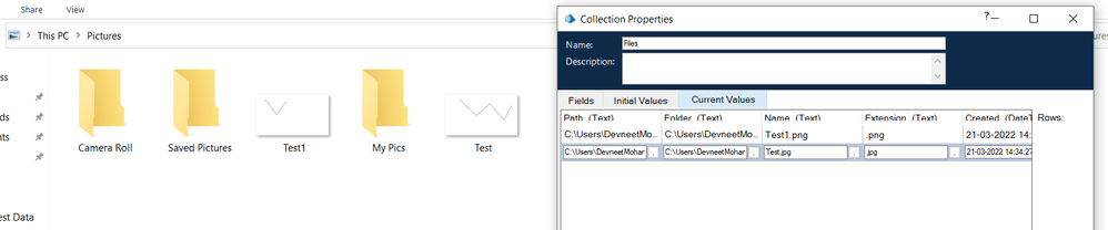

It will return all the details of the image file to you in a collection with the extension as any of the extensions mentioned above. In my example, I have two image files called 'Test' and 'Test 1' with two extensions like: '.png' and '.jpg' and you can see the inputs I provided and the output collection I receive where
the 'Name' column consists of the filename of those images.
Output:
