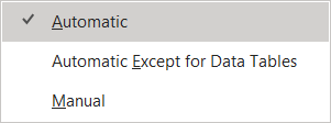

Ok, and can you verify that on the Formulas menu the Calculation Options are set to Automatic?
