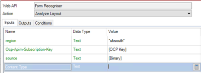

The "Analyze Layout" requires the following

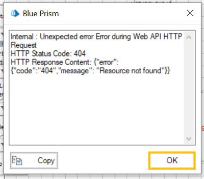

However, whenever we attempt to utilise this, we're met with the same issue:
I've scoured the community and can see a similar scenario where someone changed the baseURL to something else but it doesn't go into details as to what they changed.
We've followed the steps in the setup but we're conscious that this is from 2020 and maybe dated based on the advancements within azure?
