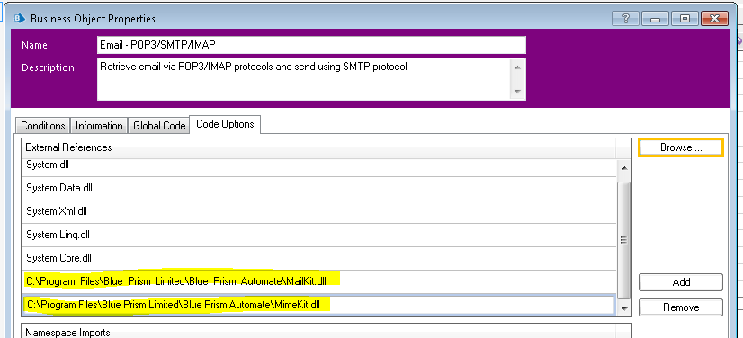

Hello, I realise this thread is over a year old, but I had the same issue, and after grappling with it for the best part of a day, I wanted to post our (simple) solution in case some future reader hits the same issue.
After saving the MimeKit & MailKit dll files from supporting materials to a distinct location in our network, a Blue Prism warning popped up to tell us we really should be putting those files in the Program Files folder of Blue Prism Automate. So we did. And we navigated to those files from the Code Options section of the properties in Initialise, to ensure they were pointed to the correct place.
Set-up causing issues:

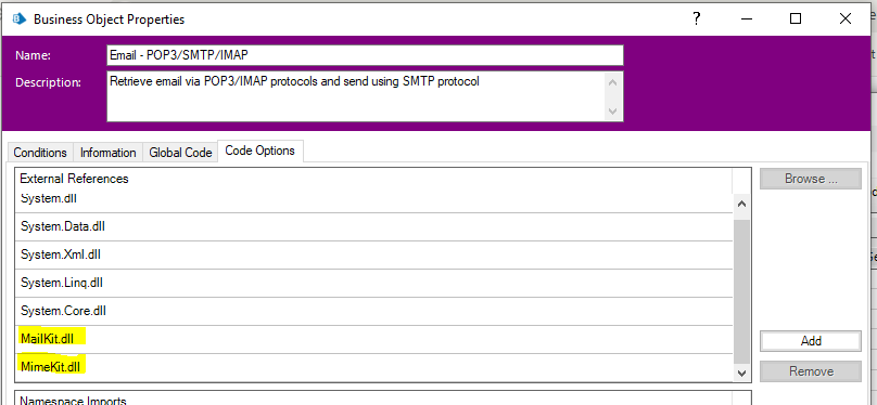

What needed to happen was for the files to be put in that location, and then to set up Initialise as pictured, with the reference being simply "MimeKit.dll" and "MailKit.dll" without the full path specified.
