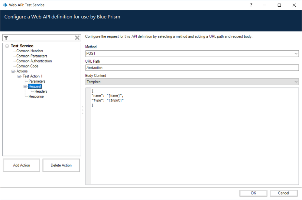

Are you working with the WebAPI service feature or a code stage? If you're using the WebAPI service feature to invoke a RESTful service you can select Template from the Request Body options and then add your JSON format as a template. Then you make the value portion of each element a parameter. Here's an example:
If you're doing this through a code stage/VBO, the answers provided by the other commenters should work well.
