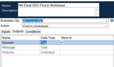

I'm trying to use "MS Excel VBO-Find in Worksheet"
But I find out it can only export Success(Flag), Message(Text), Matches(Collection).
Is there anything that I can do to get the location of the search text?

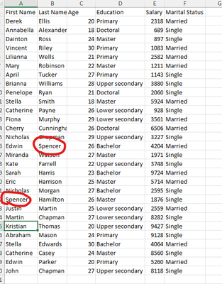

Normally  in the marched coolection you will have all your needs
See example below :

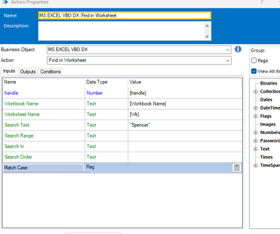

i am searching Spencer here :
When i use find in worksheet i provide this :

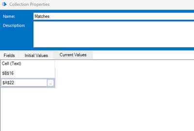

and then in the matched collection i will have this :
So it give me the correct location.
Is that anwser your request or you need more details ?

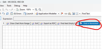

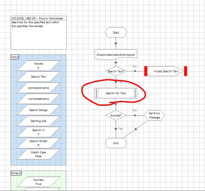

- Open your MS excel vbo that you have downloaded from DX

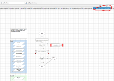

- Right Click on Find in worksheet then do duplicate
- Rename your new page "Find Entire Match in Worksheet" like this :

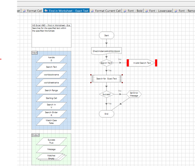

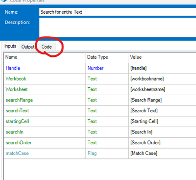

- open the code stage this one
- Rename it "Search for entire Text"
- Go to code
Put this :

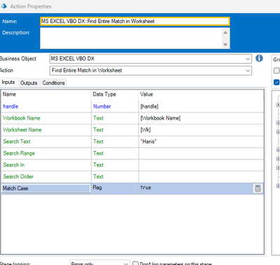

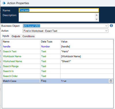

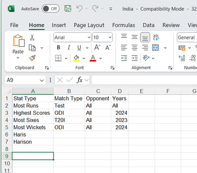

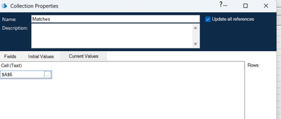

- Publish your action and now run
see example below

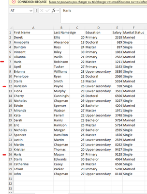

i am looking for Haris.
I provide this
My matches give me the good answer
Try it and let us know with  @Michael_S  🙂

To avoid error please rename the code stage and publish the page.
Now call the above action in MS Excel VBO, give the search name as "Haris" and now you will get only Haris cell locations as Output result
Please let us know if you face any difficulties in Implementing above.

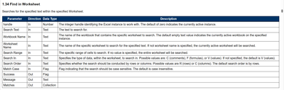

In addition to it I'm attaching the Input Parameter descripts for the Find in Worksheet page
@Michael_S
The above code should help our Blue Prism users obtain the exact output results as cell locations
