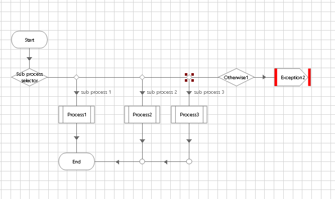

03-08-21 03:18 PM
put a choice stage to select sub process based on the input sheet in the main process
