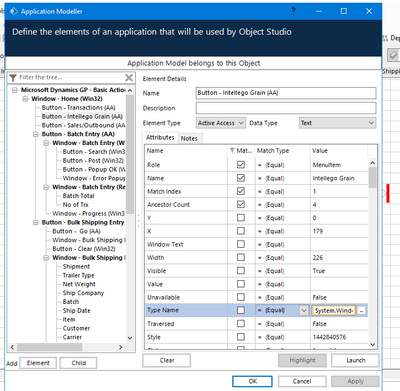

I am having issues with getting the system to click on a menu item from a dropdown list. This process worked fine on Friday but failed on Monday. We have two different companies and they both have this same step, the other company works fine.  Any ideas how to fix this?

4 - Why are you using "Ancestor Count" as an attribute? This is fine and sometimes necessary to use, but this can easily break with even just a minor difference in the screen structure even if not visible to the eye.
5 - Have you re-spied the same element to see if it is has some difference?
