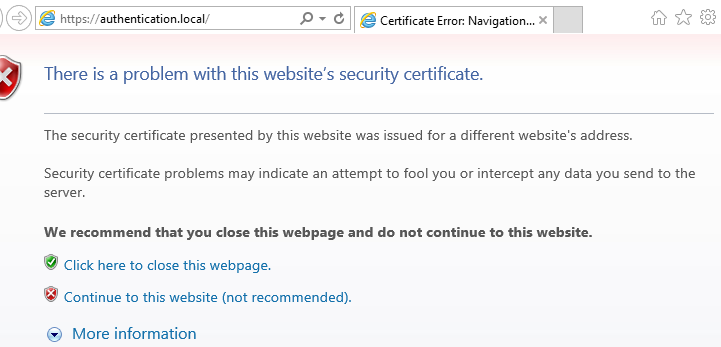

Please can anyone help with this Error,

02-08-21 04:41 PM
i did but still, i have this error on the authentication site
what should i do
aseel odeh
what should i do
aseel odeh

02-08-21 05:09 PM
i have the same problem from other browser
aseel odeh
aseel odeh

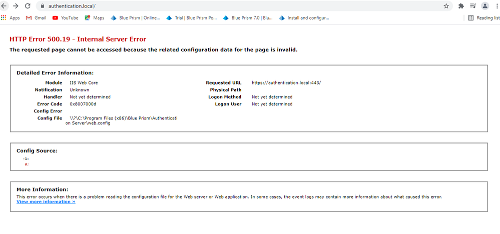

17-09-21 03:39 PM
Hi guys,
As i am facing same issue by trying all the above steps followed to resolve the problem but still the issue is appearing here.
can anyone please help me to resolve it.
i am trying to reach the https://authentication.local url
ramprasad vaddepally

21-09-21 08:00 AM
Hi, Ramprasad,
can you try to restart IIS and can you check what is written to log files? That should give us better insight what the root cause can be.
Zdenek
