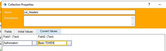

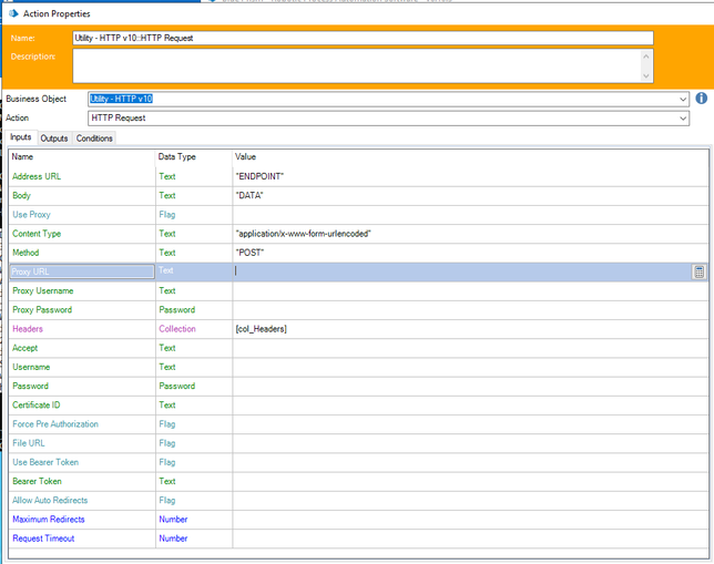

I need to replicate this call from the HTTP Request obj V.10:
curl -k -X POST -H "content-type: application/x-www-form-urlencoded" -H "Authorization: Basic TOKEN" -d "DATA" "ENDPOINT"
I am filling the fields in this way
I am pretty sure to compile all the fields correctly except than the information "-k".
Do you find any mistakes in the compilation? How can I insert the "-k" information in the action?
Daniel

"-k" with curl specifies that it should be an insure (no certificate checking) connection. There is no capability for that directly within the HTTP VBO, but there is a dedicated VBO available on the DX that can disable certification checking. However, this should NOT be used in production as disabling certificate checking creates a security vulnerability.
The VBO for disabling certificate checking can be found here: https://digitalexchange.blueprism.com/dx/entry/3439/solution/disable-certificate-vbo
Just add an Action stage calling the disable action before calling the HTTP VBO and you should be good to go.
