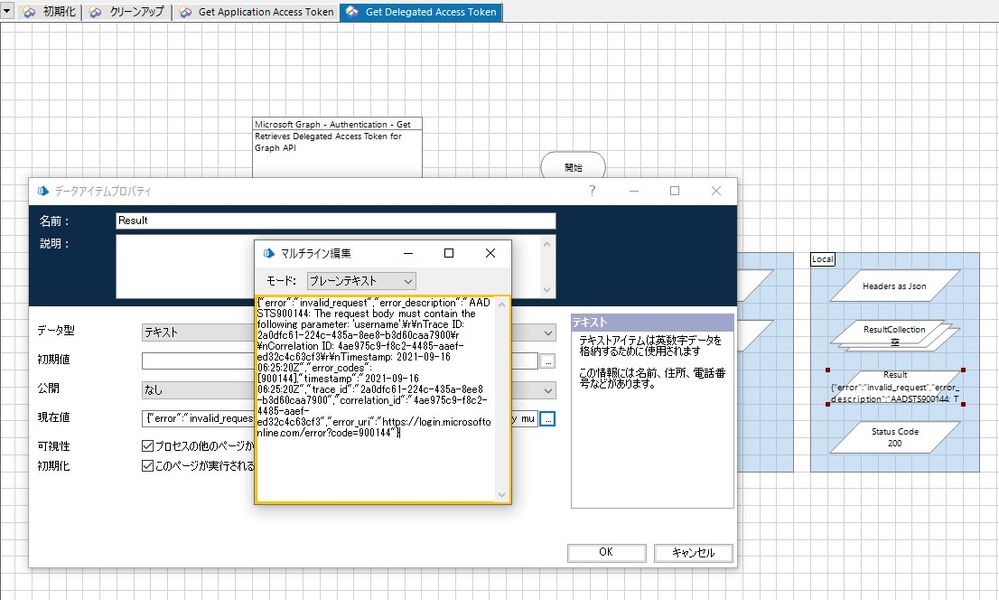

Currently, I am aiming to obtain an access token using MSG.
But, an error like the image is displayed.
I tried editing the HTTP Request object with reference to the MS docs.
Takayuki Okuda
Since the supported types are "individual", all permission types are "delegated".
I don't understand it's an Azure configuration problem, an HTTP object problem or something else.
I would appreciate it if anyone could tell me.

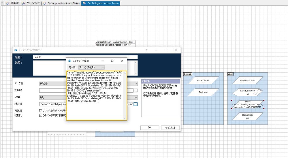

17-09-21 02:49 AM
Hello Mr.Eric Wilson,
thank you for your support.
I tried your advice but it show this error.
Does that mean there is a problem with the Azure settings?
The following is a list of API permissions set in Azure.
Some may not be needed.
Please confirm the above.
Okuda Takayuki
Okuda Takayuki
