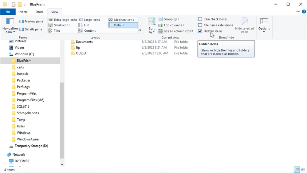

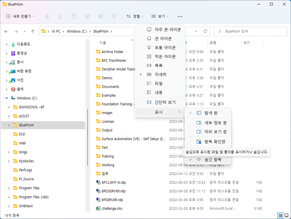

Files and Directories have attributes.
The hidden is one of those attributes.
In the command prompt you can see those files using "dir /ah", which means show hidden files in the directory.
As such, Windows explorer has also this kind of option.
In Korean explorer
In English explorer

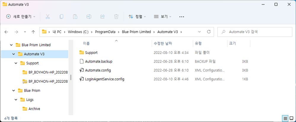

Blue Prism also uses C:\ProgramData\Blue Prism Limited directory for storing configurations files for itself and add-on components, log files, archive files and so on.
In Korean explorer
In English explorer
