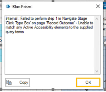

Our AA Elements have stopped working today – they have worked previously and work when we run them immediately after 'respying'. We can highlight them when spying them, but when running the process we get the below error and the elements fail to spy after this point.
Nothing changes and this was working yesterday so just curious if anyone has experienced this before.

Hi @jamie.mcpake,
Have you used "Activate Application" before working on the application?​
It might be possible that the application is not at the front and AA mode requires the application to be always available on front otherwise it stops working. It might also be possible that you have selected a lot of attributes which is causing the issue. We have to be extra cautious while selecting the right attributes. Lesser the attributes, greater the speed. Also, you can add a screenshot functionality to take the screenshot of the exact scenario happening in the production environment.
