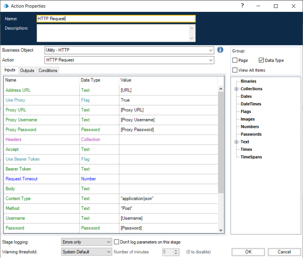

I am try to do a API authentication using HTTP- Request. There i am giving bellow information.
URL-The api url
Body-It contains username, password token
proxy url
content type as application/json
method=post
But i am getting response as Access Denied. Your credentials could not be authenticated. Credentials are missing. You will not be permitted access until your credentials can be verified.
But the credentials being passed is correct. Could you please me here.

28-10-21 06:21 AM
Hi Kumari,
Based on the info you have listed, I would envisage the VBO can be used in the following way.
Not sure if your proxy requires username and password. If not, just leave them as blank. I would also assume the username and password you had in the first post was what is needed for basic authentication, but not for proxy.
Also I am using the latest version of the HTTP VBO from the DX, if it appears different than yours.
If you are still not getting results, I would suggest you use a tool like PostMan first. This would help with any things you may have missed in understanding the web service. If you have managed to have that configured, it should be easy to map it to Blue Prism.
Lastly it was not clear to me where the error message came from, if it was the proxy or it was the API authentication process itself. Take a note of the 3-digit HTTP status code returned, that would help pinpoint the exact area you need to investigate.

28-10-21 07:27 AM
Hi Bruce,
Yes, i have configured in similar way. In response i am getting access denied . Also, as you are asked, i am not getting any http error code in error. It's just the html tag i qm getting in response which has title as access denied.
K Sikha
