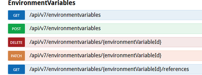

  1. Environment Variables – Is there an API to create and update Environment Variables programmatically, rather than doing this manually via the interface?

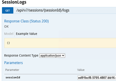

  5. Execution Logs – Is there a way to pull process execution logs (session logs) via API for a given run, rather than exporting manually from Control Room?

1.Yes, APIs are available for creating and updating Environment Variables (EVs).

5.Yes, APIs are available for retrieving Session Logs. However, I believe there may be limits on the volume of session log data that can be exported through the API. I will verify this.
