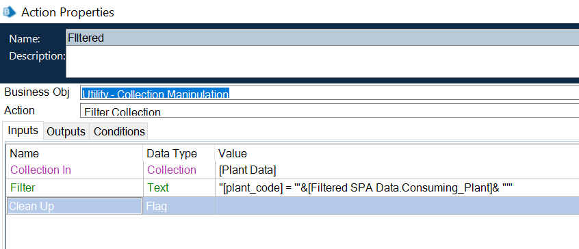

Hello Ernest Christian Javier , The error message you posted above it usually occurs when you attempt to insert a number with large number of digits into the BP database where the Database column or field does not allow to have such large value or does not have the capacity to load it up as it exceeds the limit.
What I would suggest is try narrowing down the Loading part with only what's necessary along with Key Identifier and later on you can use that key ID to do Filter collection expression to retrieve the values and add it back in the items retrieved from get next item or best is to directly use those filtered values from collection as filter collection will give you single line if it retrieves basis on unique identifier where the collection has one row for each unique item.
e.g. -
let me know if you have any difficulties implementing this.
