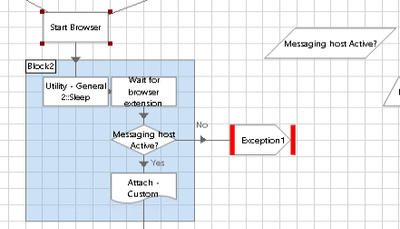

Facing same issue, what we did as a workaround is
  1. 1st Action- launch browser using start Process Action from Utility - Environment object.
  2. 2nd Action- Wait for this process "BluePrism.MessagingHost" from Utility - Environment object, Timeout set as 60-120 seconds.
  3. 3rd Action- Attach to launched browser once Action 2 completes.
This has solved the warning issue for me. these actions can be inserted in your existing object's Launch page (replace with LAUNCH navigate stage), and existing Attach page can be called instead of 3rd Action mentioned above.
As i said its a workaround and hope we get an actual solution for this. Hope it helps.

I was using a script to kill Chrome when the processes got the status warning, but it takes at least five minutes to work.
I will use your solution, thanks again.
