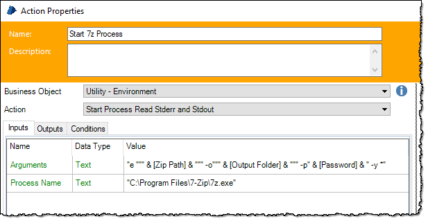

For that I would resort to using "Start Process Read Stderr and Stdout" action in Blue Prism's "Utility - Environment" VBO. By calling the 7-Zip command line executable, you can pass in a password to extract the files from the zip file:
The "Arguments" parameter can be something like:
"e """ & [Zip Path] & """ -o""" & [Output Folder] & """ -p" & [Password] & " -y *"
You can look up "Command Line Version" from the UI version's help to see what all the commands and switches are about.
The nice thing about using the "Start Process Read Stderr and Stdout" action is that you can get all kinds of feedback on the extraction in the two output data items:

Hello, I was still having issues with it running in control. It seemed to be leaving a window open although I had sent terminates to both parts of the object.
I had then started looking into running this with the 7z process and had finished my testing directly on CMD and then in a batch file. I was wondering the best way of getting this into BP though and this is it exactly. It took a few minutes as I already had the arguments from my batch file and inputs for the locations and password.
As you say I also now have output included too which is awesome. Thank you @MichealCharron  (and you too @Daniel_Sanhueza )
I will see how this runs automatically tomorrow but I think it will work perfectly. Thanks again
