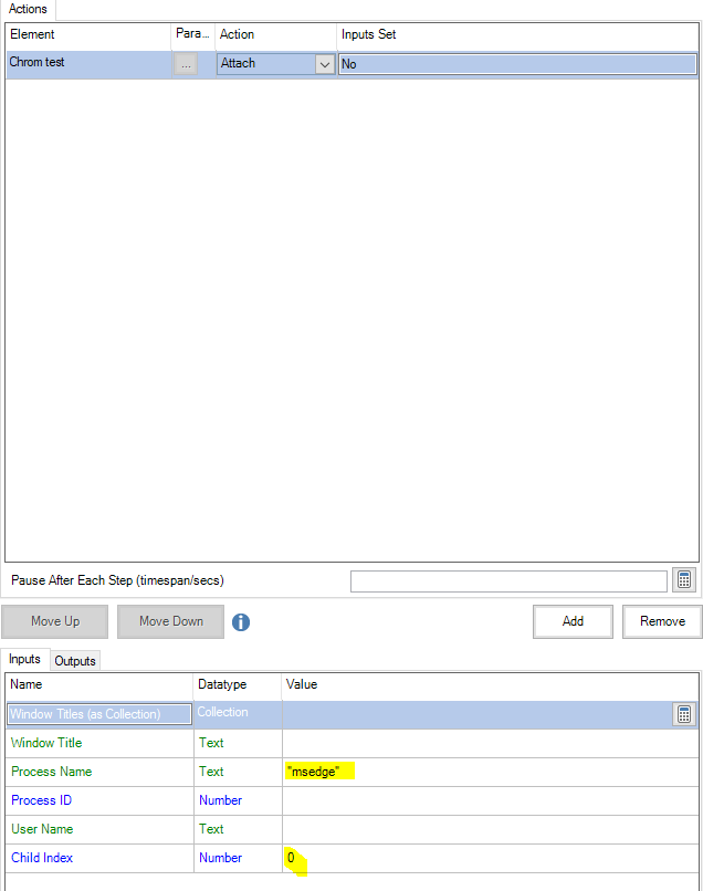

Hi Frankie,
You may be spying the inner area of the browser that's why it is always appearing as "Chrome legacy". Please take the outer border like below image,
26674.pngIf you spy like this you will get the proper window text.
Always pass Child index as 0. If you pass the window title or process name.
Process Name you can find in task manager like below, Process Name is for edge "msedge". Always exclude .exe.
For attaching any browser, always give the process name and child index as 0. It will work for sure. Attaching using the window title is always uncertain in case of the browser.

Thanks for responding Amlan, its a strange one as i was in ms edge when i spied the application window page but the window title came up as chrome Legacy  as per my screenshot  above,
i opened up the browser page where the application log on site sits and then went to view page source within here i could find the title
I input this in and my attach worked once then i retried it and it didn't work again same error?
what would the process name be using edge and would the child index also be 0?

Hi Frankie,

Amazing - that has worked - thank you so much :)!!
