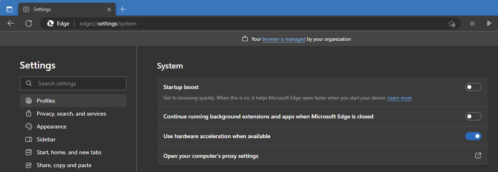

A company with which we're contracting suggested I change my browser settings to avoid this problem. With Edge's system settings configured as seen below, my problem has been gone for a few days and not resurfaced.
