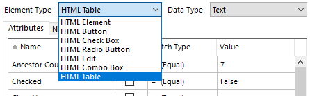

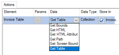

We have many automations using IE with HTML Mode. This has been very stable and ease of use extremely helpful with the following Elements types below. In particular grabbing data in an HTML table to populate into a BP collection. We did this in IE by spying the HTML table and then using the 'Get Table' in the Read Stage of the Action.
In Browser Mode against Chrome - I am unable to spy the table.
Is this a compatibility issues with the version on BP we are on against the version of Chrome?

I have raised the same issue for Blue prism version 6.4 onwards. Now in 6.9, they came up with lot of solution and it is working fine. It i reading table similar to IE. But one drawback in IE you spy any element also then you can able to red table but in chrome it is not possible. For reading table you have to spy as a table then only you can read the whole table.
