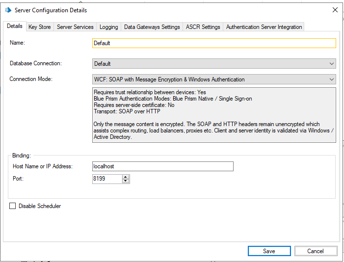

At first i ran BPserver.exe and configured the default connection.

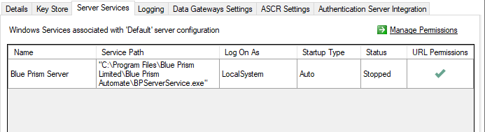

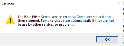

Later i opened windows services and started Blueprism server service but getting  below error
when checked in event viewer it is showing the below error
BP Server Services details
i am not sure why event logs is showing as "Server configuration Default is not defined" even though i configured correctly.

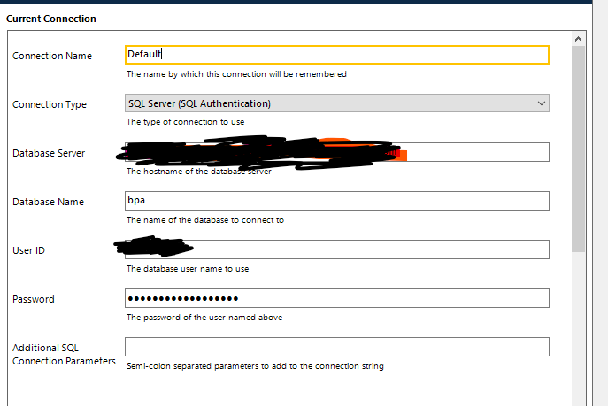

On the machine where you configure BP Server Configuration, have you happened to configure Blue Prism configuration to the database under the name of Default? You will need to do that using the main BP software.
Bruce Liu

Hi Bruce,
I did that but still getting same error.

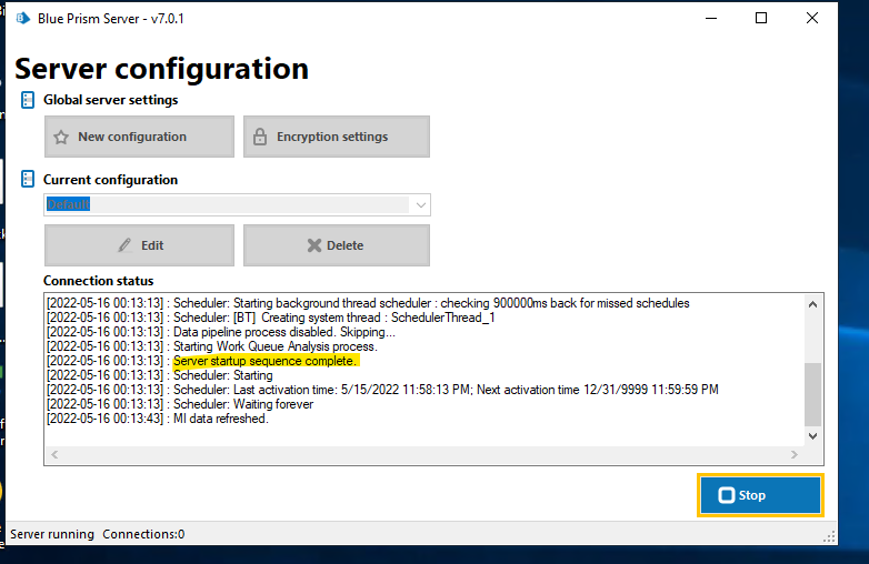

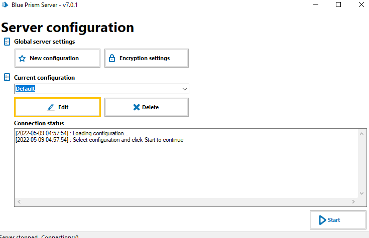

Hi G Sravan,
Next thing you can try is to hit the "Start" button on the Server Configuration screen. Kindly note down any error displayed in the console window. That may give you a clue on what is not being configured correctly.

Hi Bruce,
When clicking start button on the server configuration screen, it is starting fine.
