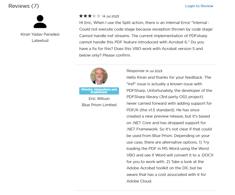

Hello BP Community,
I do have an project requirement to do a PDF page split. Currently I am using #PDFsharpdll to do a split. But split is not happening  for some of the pdf files which has higher version of pdf. The following error has been thrown
"Cannot handle iref streams. The current implementation of PDFsharp cannot handle this PDF feature introduced with Acrobat 6."
Has anyone resolved this issue? Is it possible to resolve using #PDFsharp
Please share your inputs to handle this issue.

VidhyaAnbalagan
Thanks @LeonardoSQueiroz!
PDF sharp dll version is old for me. I've update it with latest version. issue is resolved for now.

Hello vidhya,
there is a topic about this issue on the digitalexchange, check if it helps:  https://digitalexchange.blueprism.com/dx/entry/3439/solution/pdf-management-2

Hello Vidhy!
Glad it went right. Thank you very much for sharing the solution.
