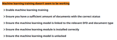

Have you checked out this topic in the troubleshooting pages?
First thing I would check is machine learning has been enabled in the config file.

Yes, we have tried all of the troubleshooting steps and have enabled machine learning in the config file

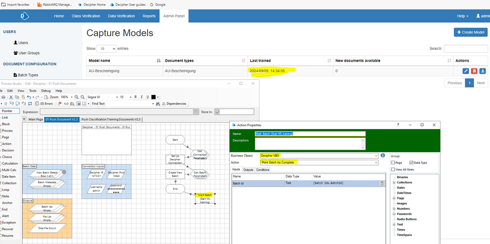

The document count is based on those which have been fully processed, this includes the export stage. In v2.2 and older this is automatic as the message is pushed to Rabbit MQ, in 2.3 this is now a manual step. So for a document to count towards the ML training it needs to be marked as complete by the respective VBO action.
09-09-24 03:41 PM
Hello Ben, Yes that's right, the data will be trained after marking the Batch as completed using the VBO action. Thx
