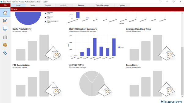

Dear All,
We have a number of charts that have been enabled by the administrator but do not have any data:
How can these be updated with the relevant data please? On the other hand the Process Logs are being updated correctly...

You have to change data source from Analytics > Tile Library > double click on available library and select data source.
Please let me know if you need more clearity.
