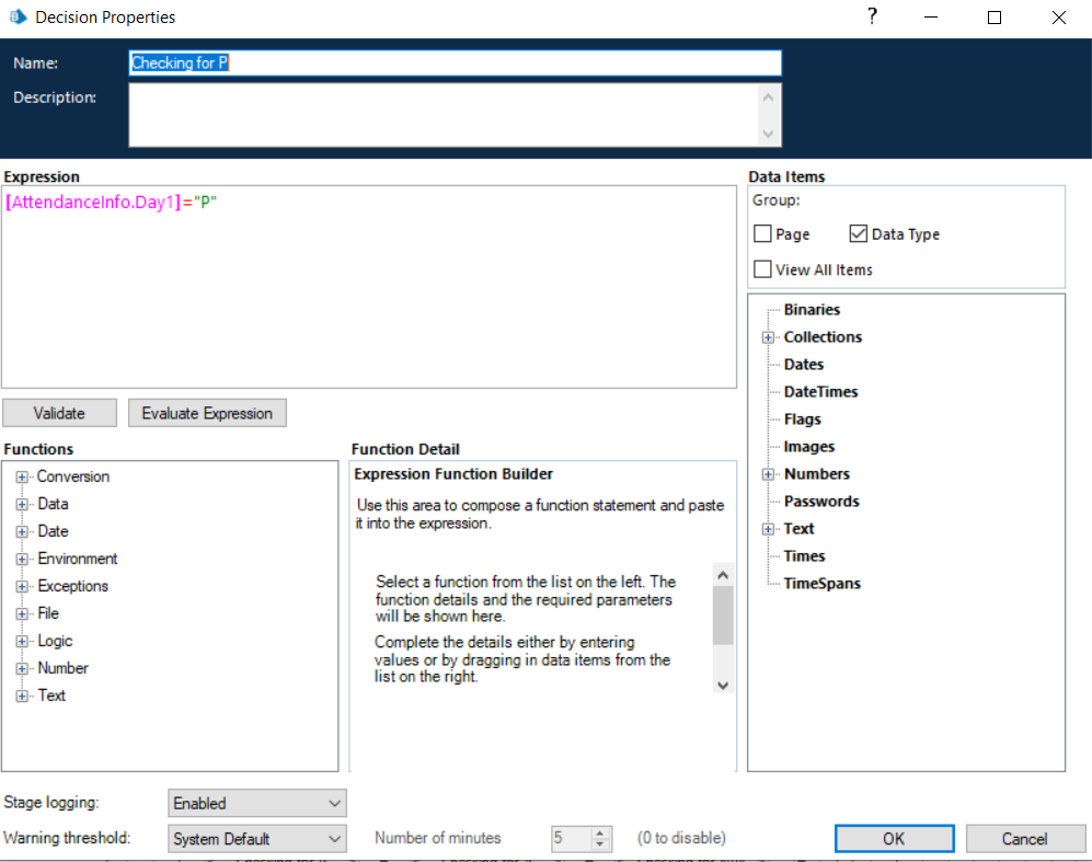

I am trying to concatenate Collection entity in a Data Item. I am unable to figure it out.
Instead of  [Choice.Day1], need to replace with [Choice.[Input]]

It's a bit difficult to understand what you're trying to achieve.  Could you show an example with some dummy data, or a screen capture of what result you're trying to achieve?

Trying to replace [AttendanceInfo.Day1] . Want to replace Day 1 Item with a Data Item [Input]
Priya Nandhan Rajendhiran
The Data Item is a Text. It has String Day1, Day2, Day3 which increases every iteration.
The "Decision" stage is not the appropriate stage to use here.  You should use a "Calculation" stage which looks like a Hexagon.

Yes tried there. It didnt work.
Fixed it through, Read Collection Field. Main purpose was to iterate through the Field elements!
