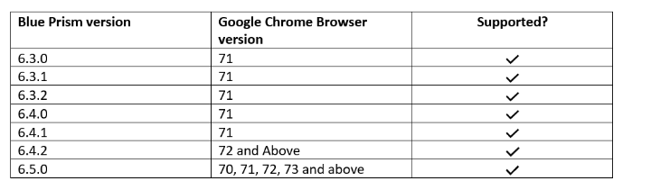

Hi Folks,
According to Blue Prism you should use BP Version 6.4.2 for Chrom Version 72 and above.
Amlan Sahoo
