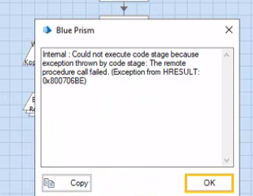

We have a Problem with the MS EXCEL VBO on Blue Prism 6.4.10, with the newest MS EXCEL VBO from Digital Exchange.

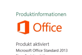

  • What version of Microsoft Excel are you using?

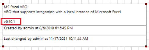

  • Just to be certain, you are using version 6.10.1 of the VBO?

the error occur not every time, but on this excel excel file it comes every time.
When we do it step by step in the debugger the failure comes. When we tried it with the scheduler not. I Don't know why.

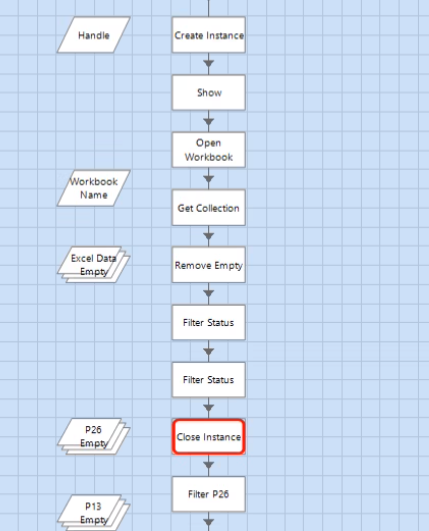

Actions before are this:
we only read in values and do not write any data into the Excel file.
Excel Version:
VBO, the lastest Version from DX Exchange

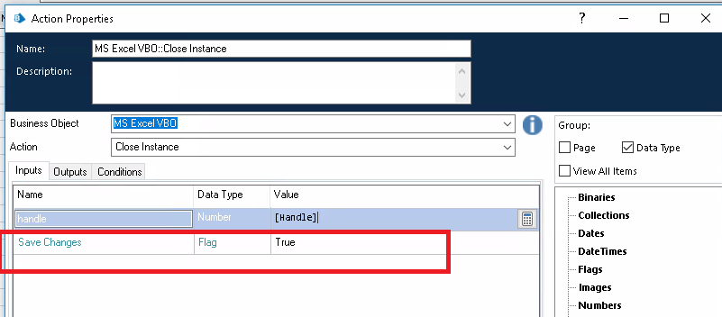

Have you checked setting the Flag as True in Close Instance Action Stage ?

But sometimes this error pops up when there are more than 3000 records in it, or someone has the file open, or Micrsoft document recovery is active, then this error also comes up. If we remove the actions (Remove Empty, Filter Status, Filter device number). or put behind the Close Instance the code always works. This is our workaround for now.

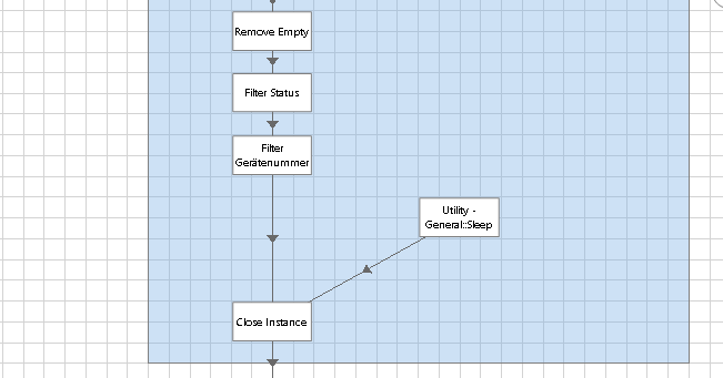

It seems that the processing in Teamviewer is slower and that's why the error occurs. Because if the RoboUser logs directly into the RR machine, then it works. But not via team viewer. Setting a sleep before the close isntance also causes the error.
