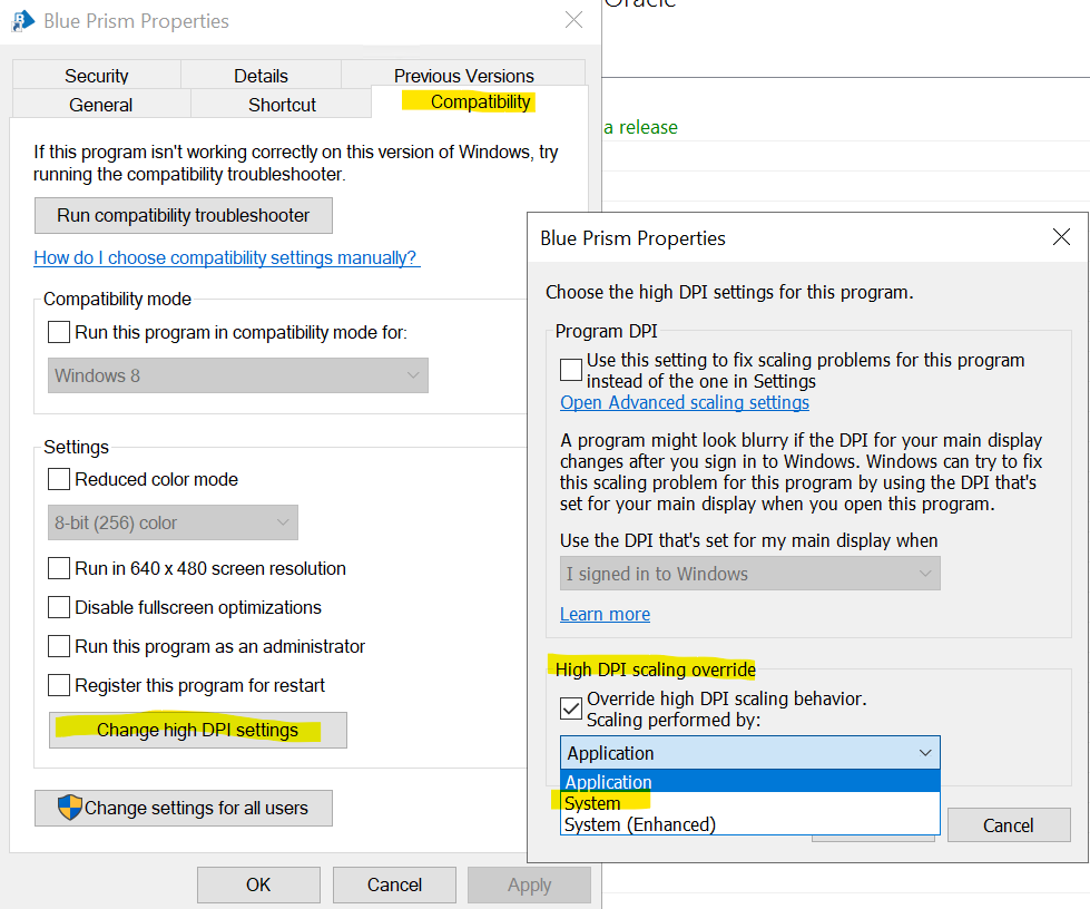

Hi @NicoleSchiller - try changing below settings and hopefully it should work -
Snippets below:
Mukesh

Hi Mukesh, thank you so much for your responds. Sadly both doesn´t work. May be it is a general issue with BP V.7.1.1.
The settings had no influence on the footer and a refresh doesn´t change the stati of Pending etc.
Wish you a nice day an again big thanks for you help , even if it didn´t work. It was worth a try!! :-)!!!
