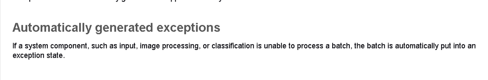

Hi Narendiran.
I was just checking and the state should be automatically set to "Exception" in the Batches tab. Looking at the documentation (Exceptions (blueprism.com)) you'll find:
16757.pngI'm looking into the reports section too.

Hi Narendiran.
After digging deeper into this, Decipher will automatically generate an exception only when it cannot process the document. Since low confidence is the result of processing, Decipher clearly could process the document. Consequently, as far as Decipher is concerned, I think we are out of luck regarding automatically indicating an exception.
