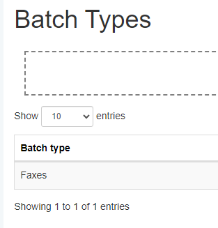

I did try with one and multiple documents, this is also giving me the same error when I just use the "Create Batch" action as well. I have the classification created as well as the batch type. Here is what the information looks like for Create Batch. There is a batch type in Decipher called Faxes, and a Documetn type called Consult Notes.

To wrap back around to this. It seems it was a port issue. I was attempting to use a custom port, but the submission port needs to be the same as the Rabbit QM setup (12543). Batch was successfully sent after this change.
