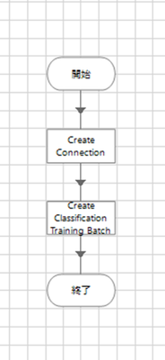

I referred to this page:
https://docs.blueprism.com/ja-JP/bundle/decipher-idp-2-3/page/user-guide/classification-model-training-guide.htm
- "C:\Program Files (x86)\Blue Prism\Decipher Automated Clients\SsiDataCaptureClient.exe.config"
set "EnableModelTrainingML" to True - create Capture Models

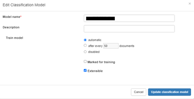

set "Mark for Training" to ON - create Classification Models

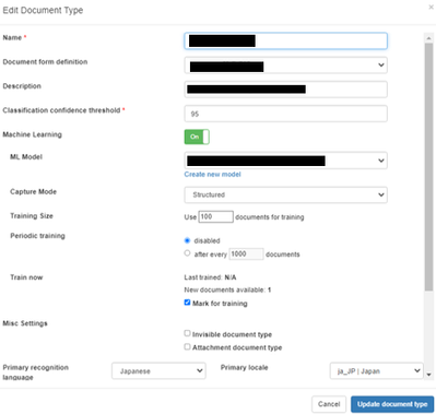

set "Marked for training" to OFF, "Extensible" to ON - amend Document Types

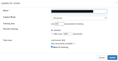

set "Machine Learning" to ON, in "ML Model" select , set "Training Size" to 100 - amend Batch Types

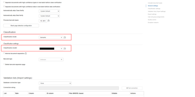

set "Classification mode" to Semantic
in "Classification model" select the created Classification Model name - create process to push a batch of training documents
- check the batch status is "Completed Class Training"

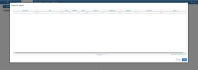

- Load batch into class verification
...my batch doesn't appear!
Are there any errors or omissions in the work procedure I have written?
Please help me

Hi @sumire ,
That's the correct page.
Classification training batches are only used to create/train the classification model. They do not pass through data extraction and will never appear in data verification.
This is because a file uploaded for data capture may contain multiple documents and the classification model will separate them. The classification model training files must already be separated into the documents, so the model can accurately be trained on what the document type looks like.
Have you completed the Decipher foundation training?
If this is still unclear, I would recommend either raising a support ticket or contacting your Blue Prism account manager on how to get additional support.
The OCR engine cannot be trained, so character extraction cannot be improved. It could be that the document quality is not sufficient.
Decipher 2.3.2 will include the ability to use one of Azure's OCR engines (for additional cost), which may provide more accurate OCR capture.
