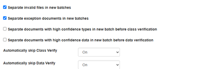

Hi @Ben.Lyons1 ,
I am facing the similar issue, where the exception documents are not separated as new batch and proceed with the correctly captured ones. Any suggestions?
Out of 6 documents in the batch, unable to capture the required fields for one document which stops the batch in "Capture performed - ready for Verify". But our expectation is to process the 5 documents in one batch as " Verify performed - ready for Export" and separate the document as batch in exceptions folder in data verify tab.
Note: In manual verification we can do that manually by going to the specific document and mark as exception which moves to exception folder and submit the remaining but in automatic data verification its not happening.
>Trained the data as required.
>In document type settings:
> In batch type settings:
>marked the same document as exception in manual verification.
settings are enabled in batch as below for auto data verify, even in config tab as well.
appreciate your suggestions.
Ben.Lyons1
Hi @kiranb25 ,
Decipher won't automatically identify an exception, they have to be done manually, there are no automatic rules for this. Decipher not capturing a field isn't an exception, it just needs human intervention.
If you want documents with the fields correctly assigned to flow straight through when the batch includes 1 or more documents that are missing fields, you need to select the "Separate documents with high confidence in new batch before data verification" for the Batch Type.
