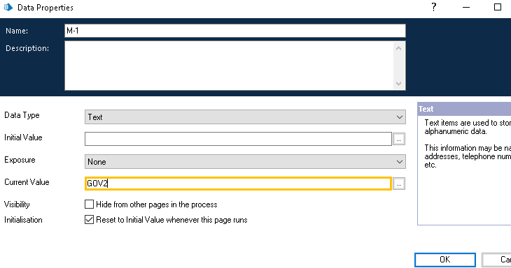

I would have 6 Data Items named according to the month to be searched for;
  • [M-1]= Month -1
  • [M-2]= Month -2
  • [M-3]= Month -3

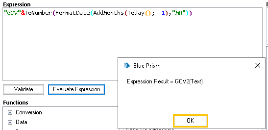

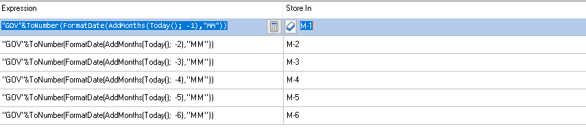

And so on... at the beggining of the process flow I'll put a Multicalc Stage that send the values to each Data Item with a simple function;
"GOV"&ToNumber(FormatDate(AddMonths(Today(); -1),"MM"))
And ensure that checkbok "hide from other pages in the process" is unchecked to make them Global so you can use those Data Items anywhere on the process flow.
Hope this helps
