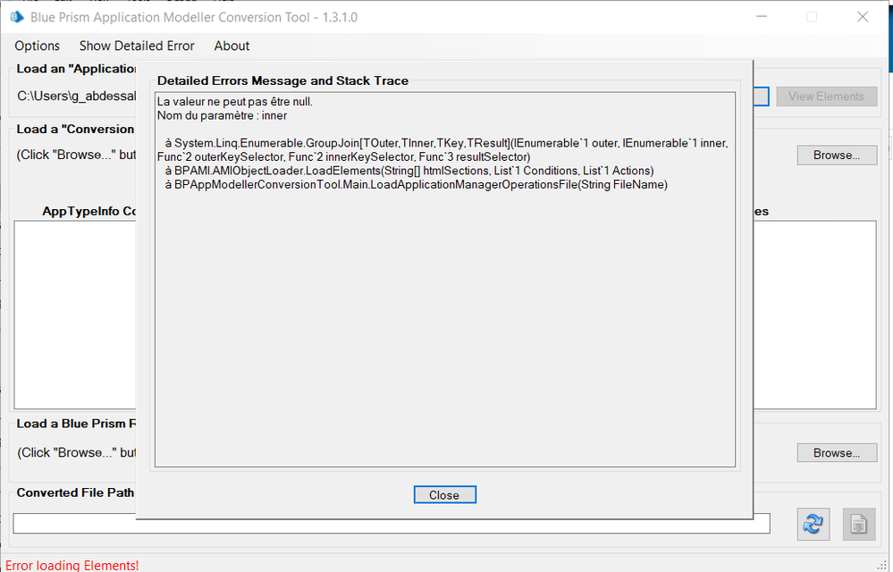

Greetings,
I'm having an issue while trying to convert a BP object from IE to chrome. The Application Manager Operations is not loaded and I'm having an error.
The error is :
"La valeur ne peut pas être null.
Nom du paramètre : inner
à System.Linq.Enumerable.GroupJoin[TOuter,TInner,TKey,TResult](IEnumerable`1 outer, IEnumerable`1 inner, Func`2 outerKeySelector, Func`2 innerKeySelector, Func`3 resultSelector)
à BPAMI.AMIObjectLoader.LoadElements(String[] htmlSections, List`1 Conditions, List`1 Actions)
à BPAppModellerConversionTool.Main.LoadApplicationManagerOperationsFile(String FileName)"
I have launched Blue prism interactive Client in English before saving the html file.
Best regards,
Ghaith ABDESSALEM
02-03-23 02:47 AM
It will be a good idea to contact our technical support team to review this case. We will need details like the version of Blue Prism.
I suggest you t try saving the file in a folder outside the C:\Users (Like using C:\TEMP to save to the project object before conversion and to save the results) to see if is an issue regarding rights.
02-03-23 08:25 AM
Hello Luiz,
I tried this in a different computer and I am having the same issue.
For the version, I am using 6.10.3
Best regards,
Ghaith
02-03-23 03:19 PM
I found the issue, when saving as => you should select HTML only.
Thank you,
