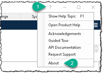

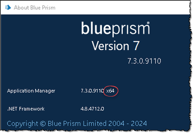

BTW, to check if you are using a 64-bit version of Blue Prism. Click the "?" (1) at the top right of the main screen and then select the "About" option (2). You should be able to see the x64 if you are using the 64-bit version.
