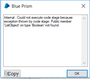

Hi All,
I am facing an issue while writing customized code in MS Excel VBO.
21740.pngAny idea on this error.

you've copied some data items/objects from a stage and when pasted to your new process, you didn't recreate those 2 data items. So you either create them with the right type, or enter into each action in order to recreate them by clicking on that button for the automatic  data item creation and therefore change the new created data items into your process/objects etc.
The main idea is that the process misses those data itemjs and you have to create them.
