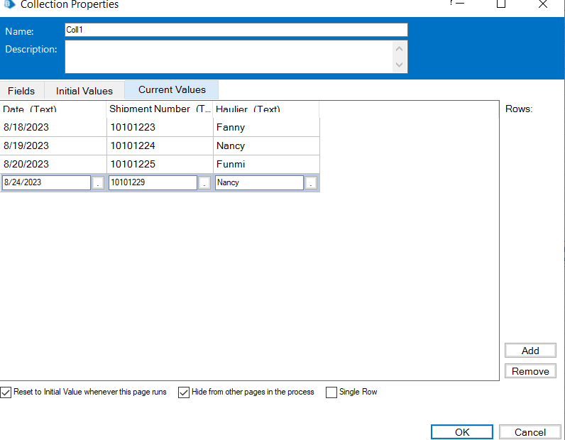

Given, for example, the following Collection named [Filtered Data]:
Date |
Shipment Number |
Haulier |
8/18/2023 |
10101223 |
Fanny |
8/19/2023 |
10101224 |
Nancy |
8/20/2023 |
10101225 |
Funmi |
8/21/2023 |
10101226 |
Nancy |
8/22/2023 |
10101227 |
Samson |
8/23/2023 |
10101228 |
Bayonan |
8/24/2023 |
10101229 |
Nancy |
What is the script to write in Collections Manipulation VBO Filter Action to extract only the Hauliers that contain "Nan"?

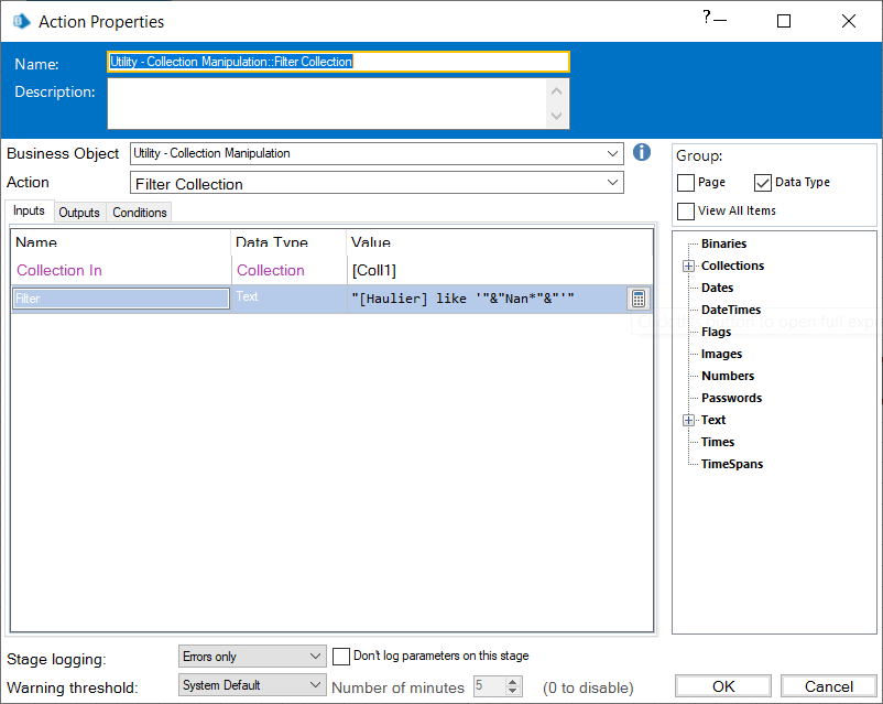

18-08-23 08:29 PM
Hi Yinka Daramola,
Try some thing like below. Assuming there are no space before the word "Nan'
"[Haulier] like '"&"Nan*"&"'"
When you step in to the collection action the text should pass to Utility collection - Filter action should be like this [Haulier] like 'Nan*'
Your filter looks like it has single quote before like which is not required also before Haulier column Name there is one more single quote.
https://learn.microsoft.com/en-us/dotnet/api/system.data.datacolumn.expression?view=netframework-4.7.2
https://www.csharp-examples.net/dataview-rowfilter/

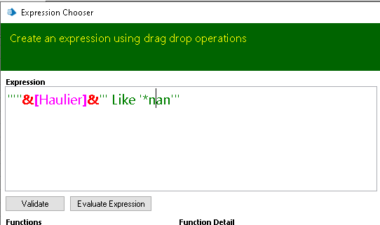

18-08-23 09:47 PM
In your question you said you were looking for a filter expression to find Hauliers that contain "nan". That is important here because it the placement of the "*" changes what is filtered.
If you were looking for Hauliers that contain "nan", you would use (4 rows returned):
"[Haulier] LIKE '*nan*'"
If you were looking for Hauliers that start with "nan", you would use (3 rows returned):
"[Haulier] LIKE 'nan*'"
If you were looking for Hauliers that end with "nan", you would use (1 row returned):
"[Haulier] LIKE '*nan'"
When you use the "Filter Collection" action, you are passing the filter string to a DataTable.Select() method. Think of it like a SQL WHERE clause, you specify your column name (the square brackets are not really needed unless you have a space in the column name but it does not hurt to have them there), your operator and then your string to compare to each row value in that column (strings have to be contained in single quotes).
Even the "*" wildcard is interchangeable with "%" like an SQL WHERE clause.

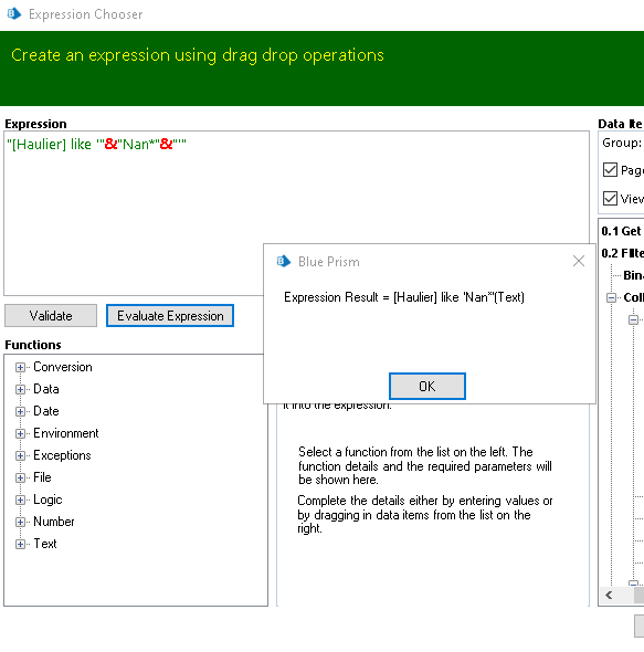

18-08-23 10:35 PM
Hi @Harish Mogulluri. Thank you for taking the time to answer this. But the script you supplied does not work. Unfortunately, Blue Prism just evaluates the expression like text and filters nothing.

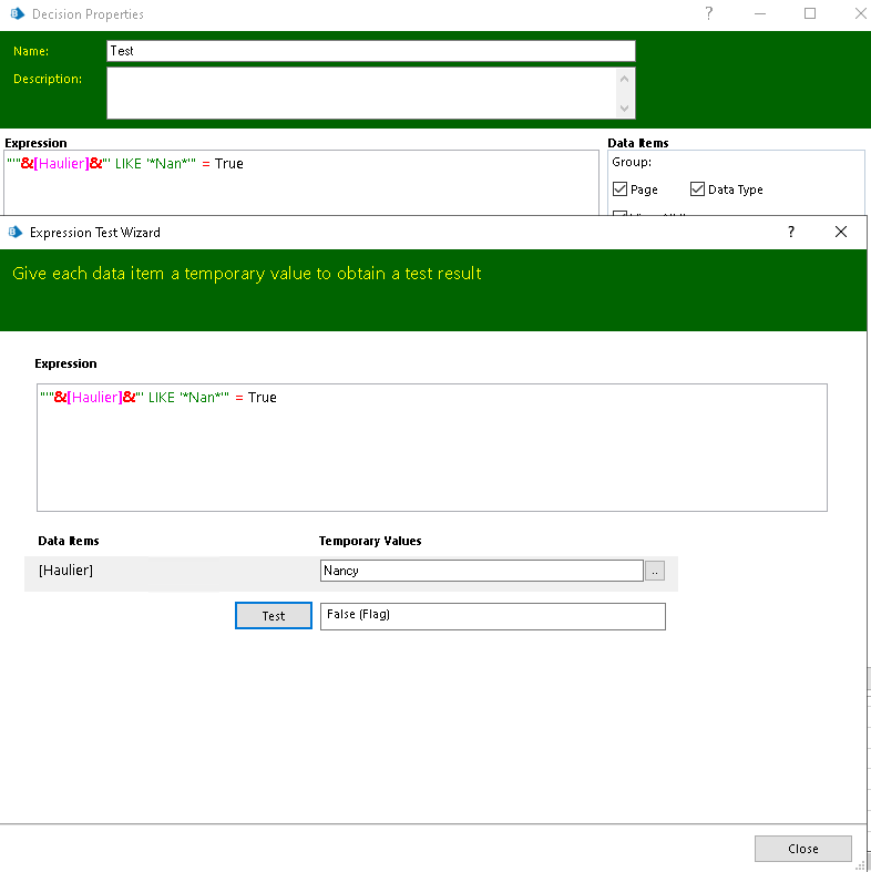

18-08-23 10:51 PM
@Michael Charron. Thank you very much for your detailed answer. I tried running the script as you supplied it on Blue Prism, but it did not work. I had to adjust the script slightly as below before Blue Prism would evaluate it as code rather than text.
I subsequently used a decision stage to test the accuracy, but it does not appear to give the expected outcome.
I wonder what could be wrong?

18-08-23 11:09 PM
Hi Yinka Daramola,
Not sure why it is not working on your end. Probably need to tweak the condition as Michael Charron mentioned
Check below screenshots
1) Created temp collection
2) Added filter condition as mentioned in my above post
Filter condition used - "[Haulier] like '"&"Nan*"&"'"
3) got the rows "Nan"
The decision stage will treat "*" as text it will not work as wild card that's why you are getting False when you try to compare
