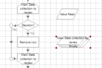

Currently I am using a regular collection filtering using a loop stage but this is taking to long to go trough a list of 500 rows or more...
I was trying to use the collection filter, but, I need to use data item ( as value read as it changes for each page run,,,,) but I wasn't able to make work....
basically in document attached it is the current actions I am taking
Anything that doesn't match the value read in that moment should be just gone from collection list....
Is it possible to add Data (value read) in the Utility collection manipulation (Filter) so it allows to do this action at once, or do you have better solution to save time?
Thank you
36868.pngThis basically the start of the action to this loop
