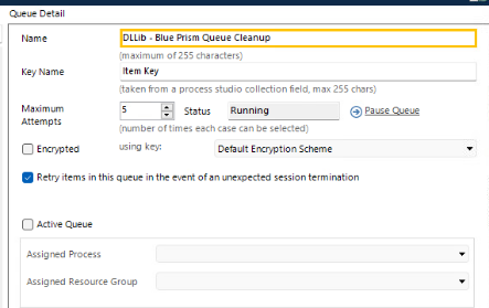

What version of Blue Prism are you using? At some point (maybe around 7.1?), an option was added to Queue settings called "Retry items in this queue in the event of an unexpected session termination". This may not fully address what you need. It definitely won't help if you're on an older version, but at least you'd be able to use this once you upgrade. Of course your maximum attempts would have to be high enough perhaps. I haven't tested whether this feature flag works regardless of the maximum attempts or not.
I don't have any input for the tag/status issue though because I haven't run into that problem, and I don't know if the setting I mentioned above would or wouldn't apply in that scenario.
