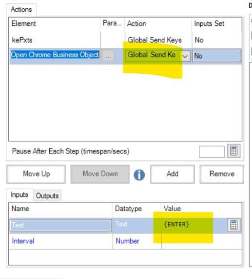

@Cameron Pirrie,
Try to give the exact Text value as
"{ENTER}" and try it once. As the error says, you need to also surround your text with the double quotes.
Also, as a best practice remember first try to send a click or make the element focused by using Click or Global Mouse Click Center action and then you provide the Send Global Keys action with the root element of your Application Tree as the element not the element where you are actually typing the text.
Hope this helps you out and if this resolves your query then please mark it as the "
Best Answer" so that others having a similar doubt can easily track the answer.
